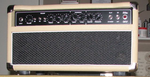

From this:
[IMG:639:329]http://i23.photobucket.com/albums/b392/ ... kKnobs.jpg[/img]
To this:
[IMG:640:387]http://i23.photobucket.com/albums/b392/ ... mknobs.jpg[/img]
Depending on how you stain the wood they could work.
When I got my D'Lite amp it had black knobs I switched them to the Fender cream barrel knobs for more of a vintage look.
From this:
To this:
