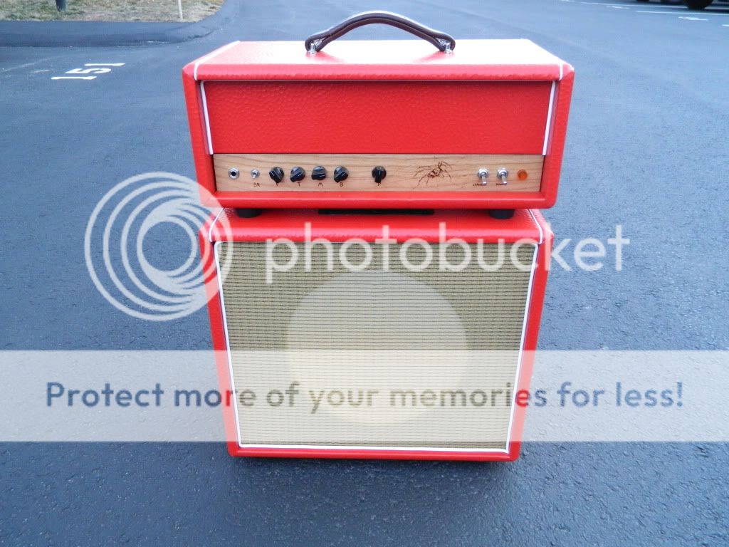

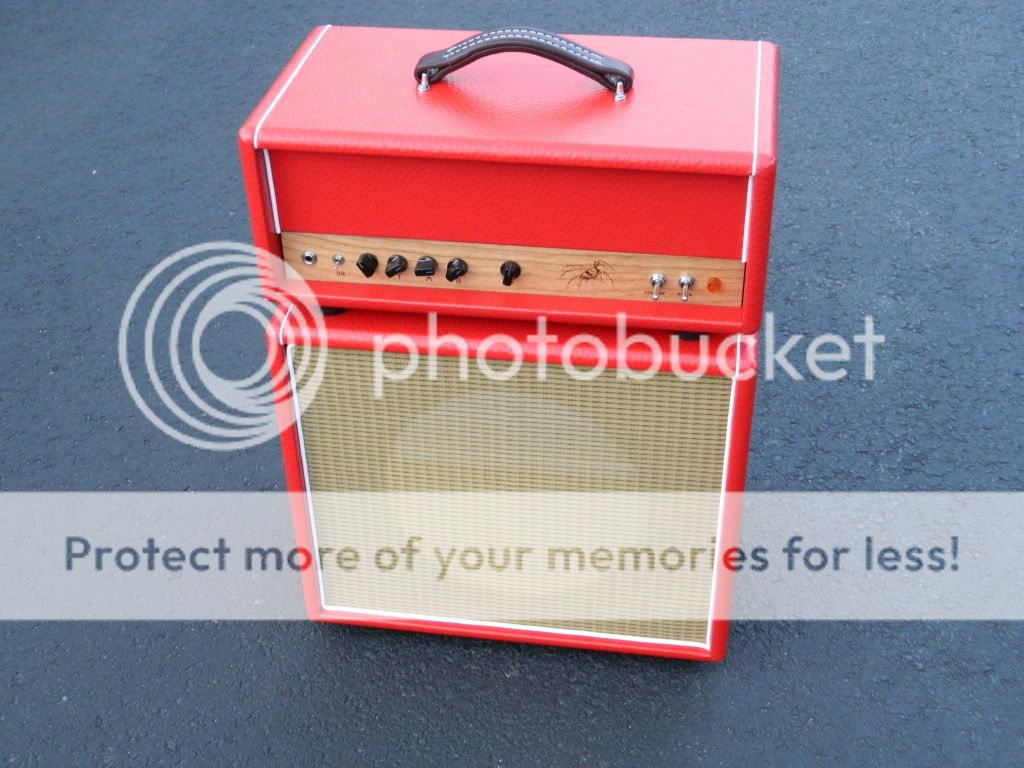

I almost have the matching 1x12 built...this thing is cool. That is "hammered red" tolex with inlay beading and the 1x12 has a recessed 4x12 side handle in the top of it. Selloutrr faceplate (the coolest!) I'm trying to figure out the best port size for the back panel.
