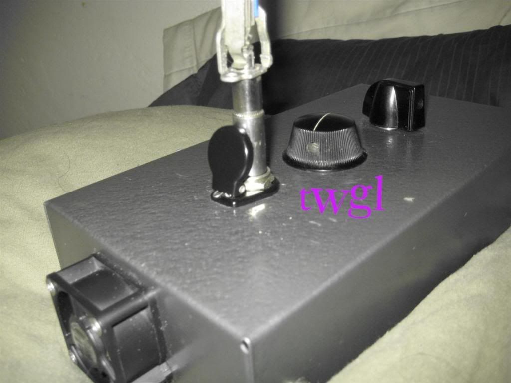

Yer still money ahead if that's any consolation...I saw a used one at TGP going for $185 shpd. That's plain nuts. There's a Matchless one there now going for the same money...I put a fan in mine as a nod to the Matchless & to prevent any liable actions should someone do something asinine. I'm curious to power it with the OT's voltage but need to confirm this as "do-able" in the Technical section.
Those shipping charges will soon be the death of me. Especially when it looks like someone is trying to retire off my sole purchase. Luckily we're not in Australia or a Euro country[Italy comes to mind] that can tack on duties & other suspect crimes.

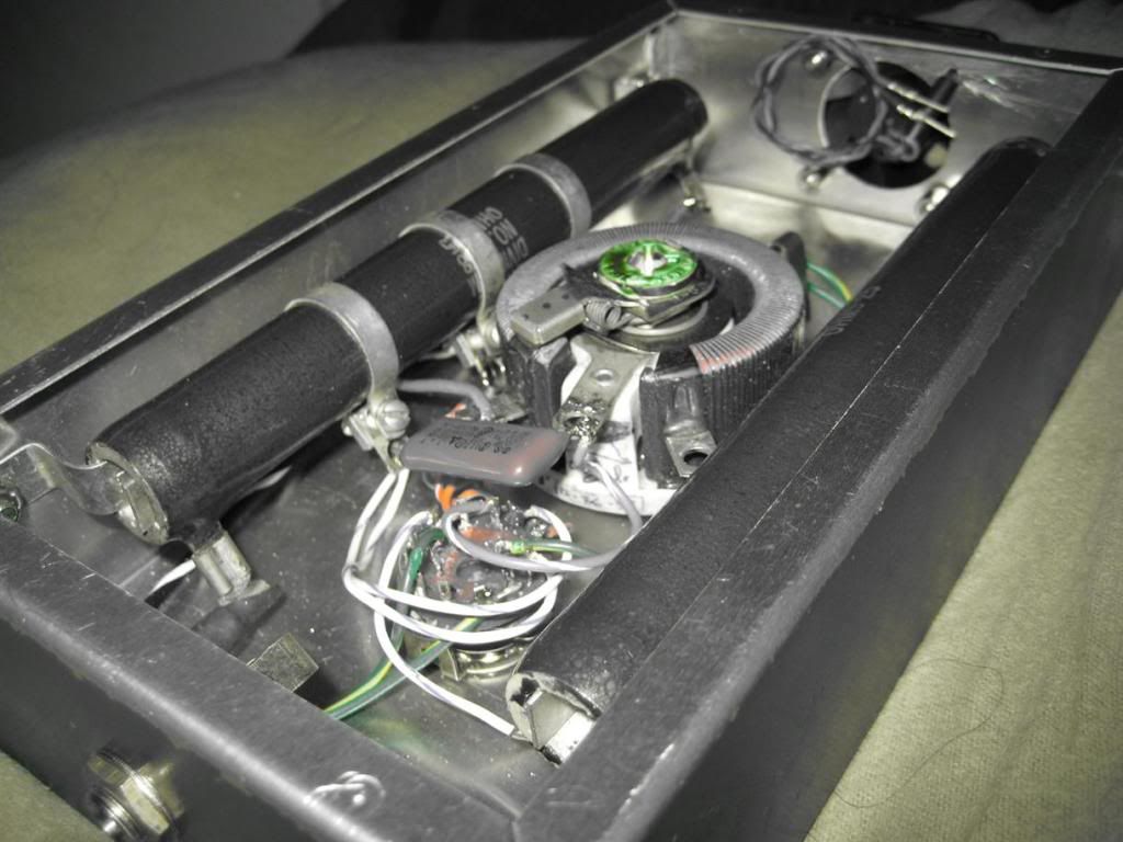

Here's the result of my endeavor;
[IMG:1024:768]http://i145.photobucket.com/albums/r222 ... ens_13.jpg[/img]
[IMG:1024:768]http://i145.photobucket.com/albums/r222 ... ns_134.jpg[/img]

Hey Noel. Excuse my ignorance but what is that fancy connector going into the top of your Airbrake.....Is that AC power for your fan or a fancy Input/ouput.....I used to work for the Navy and it looks like something I might of seen on a ship! The connector partially seen and cover)
I have a couple of fans similar to that laying around somewhere, but I'm guessing if Ken didn't install a fan it doesn't need one. I left ventilation on the ends of my box..(Installed partial sides) I don't really save anything building a chassis,being the time it takes to build one, in reality I'm money behind<(on the chassis that is) if I count my labor! I kind of like building chassis boxes.
