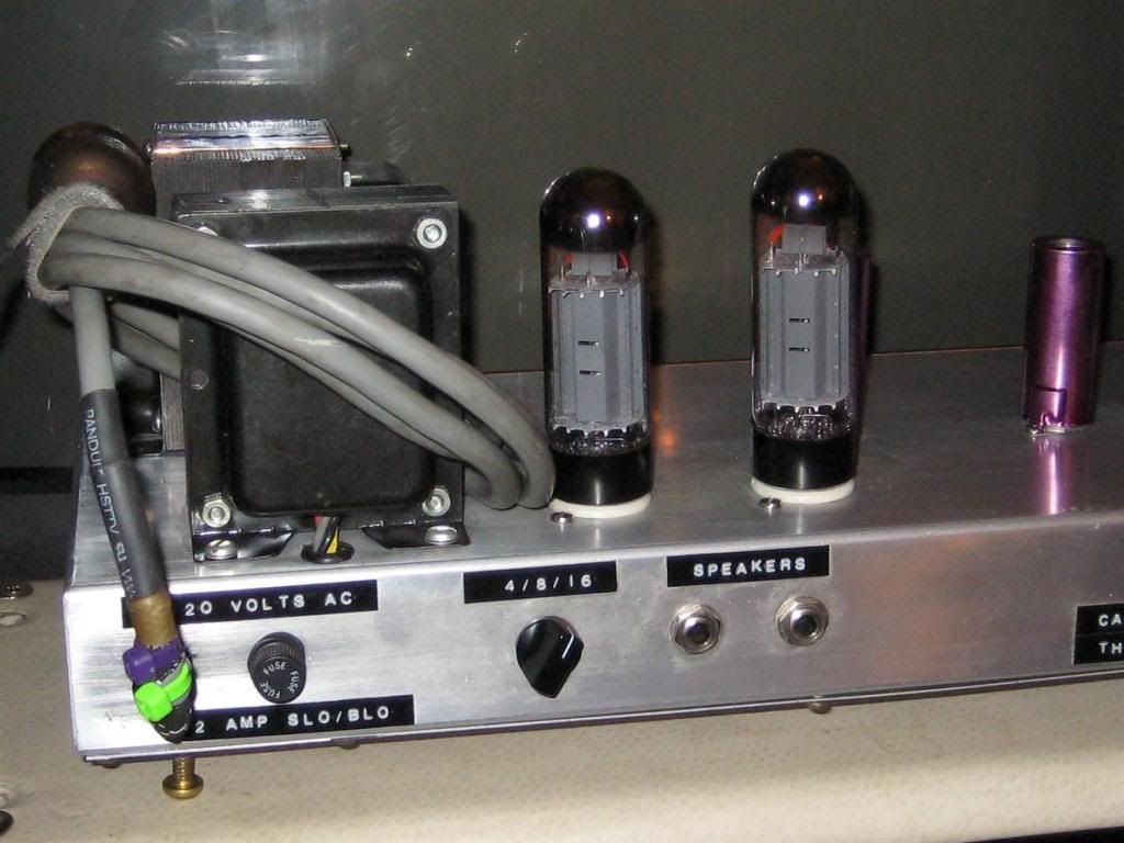

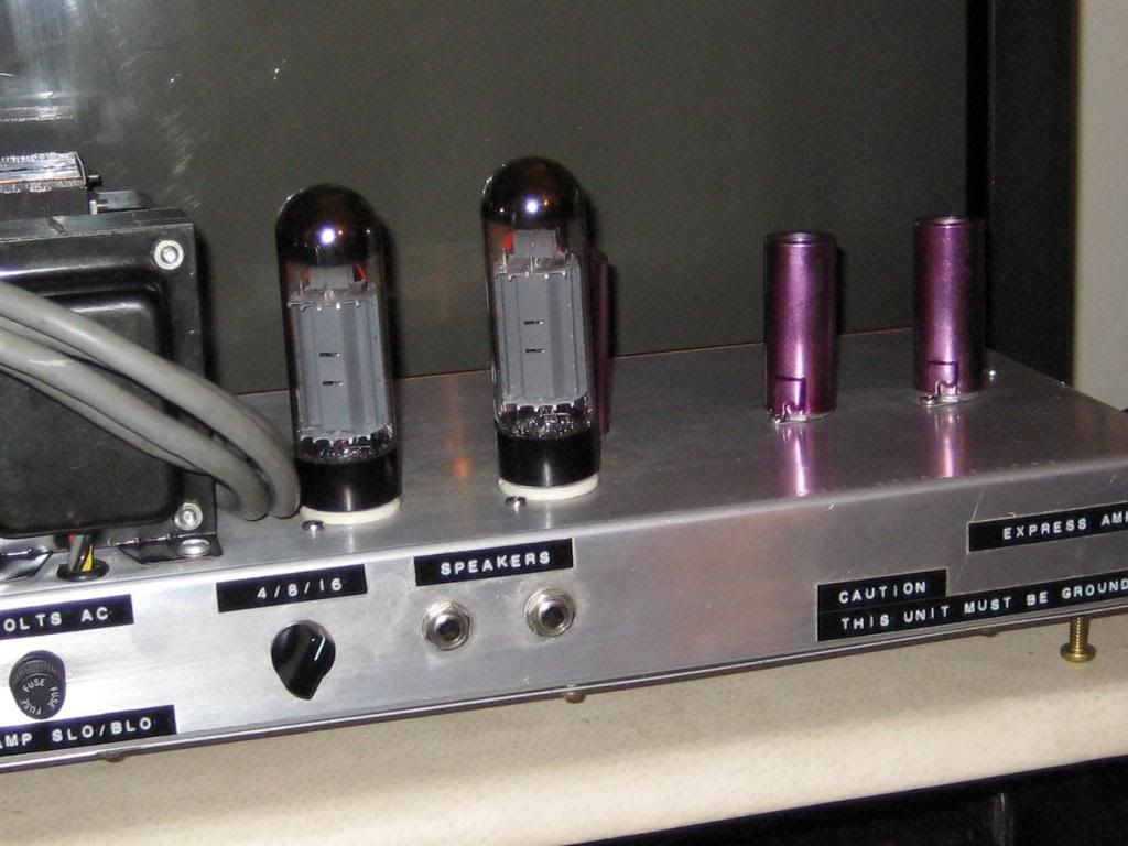

This is Debra Kadabra, brazen hussy that's had her skirts lifted previously but she
wasn't quite done yet.

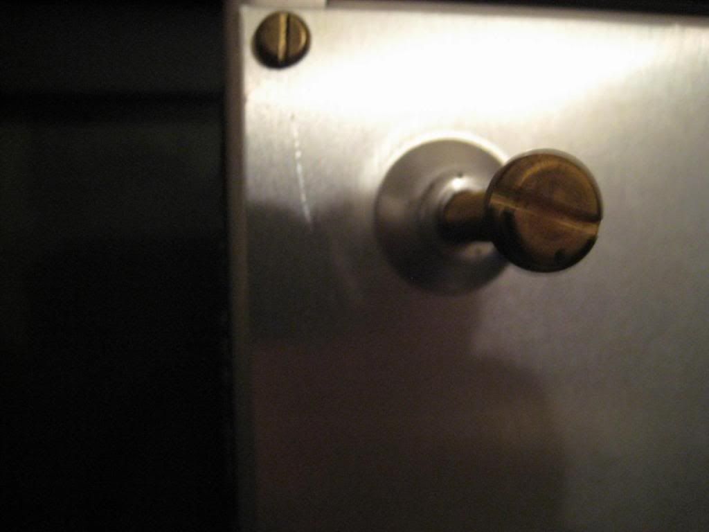

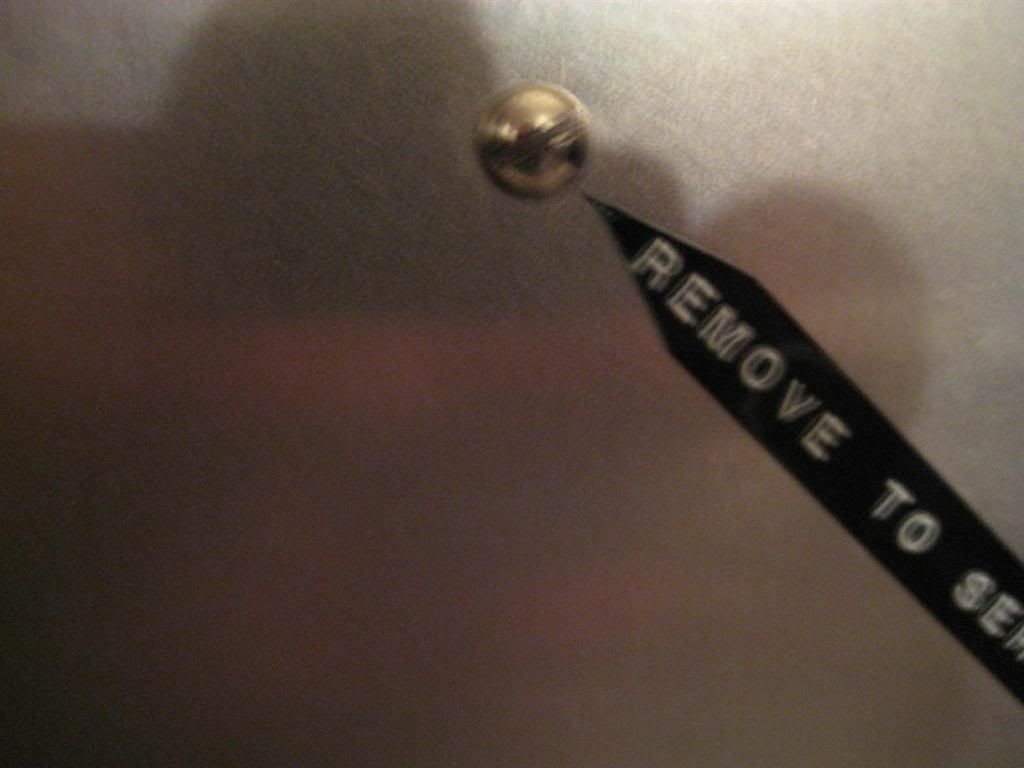

I've managed to insert the Riv-Nuts in her load pan for Kenny approved mounting
in her Cherry cab. I also did a "fakey" with the thru-bolted "Remove before Servicing" slotted, round head machine screw.

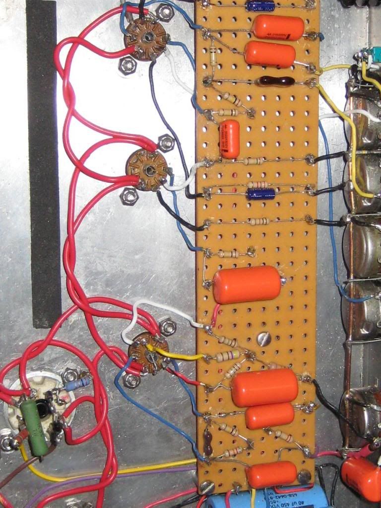

I found the Coral brand 18ga stranded to make my filament string look more

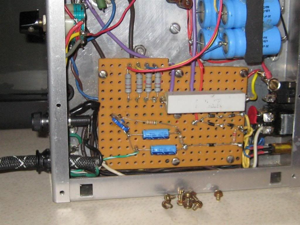

apropos. Both leads PVC Red of course. I also swung with the later style
bright switch wiring and can affirm there's not an unwanted noise in this brute
even at Max volume. Although I did perceive a Theremin-like squelch at dog
frequencies when I had the bottom cover off and I moved DMM probes over
various surfaces inside. It never made those noises again when she was
buttoned up.
