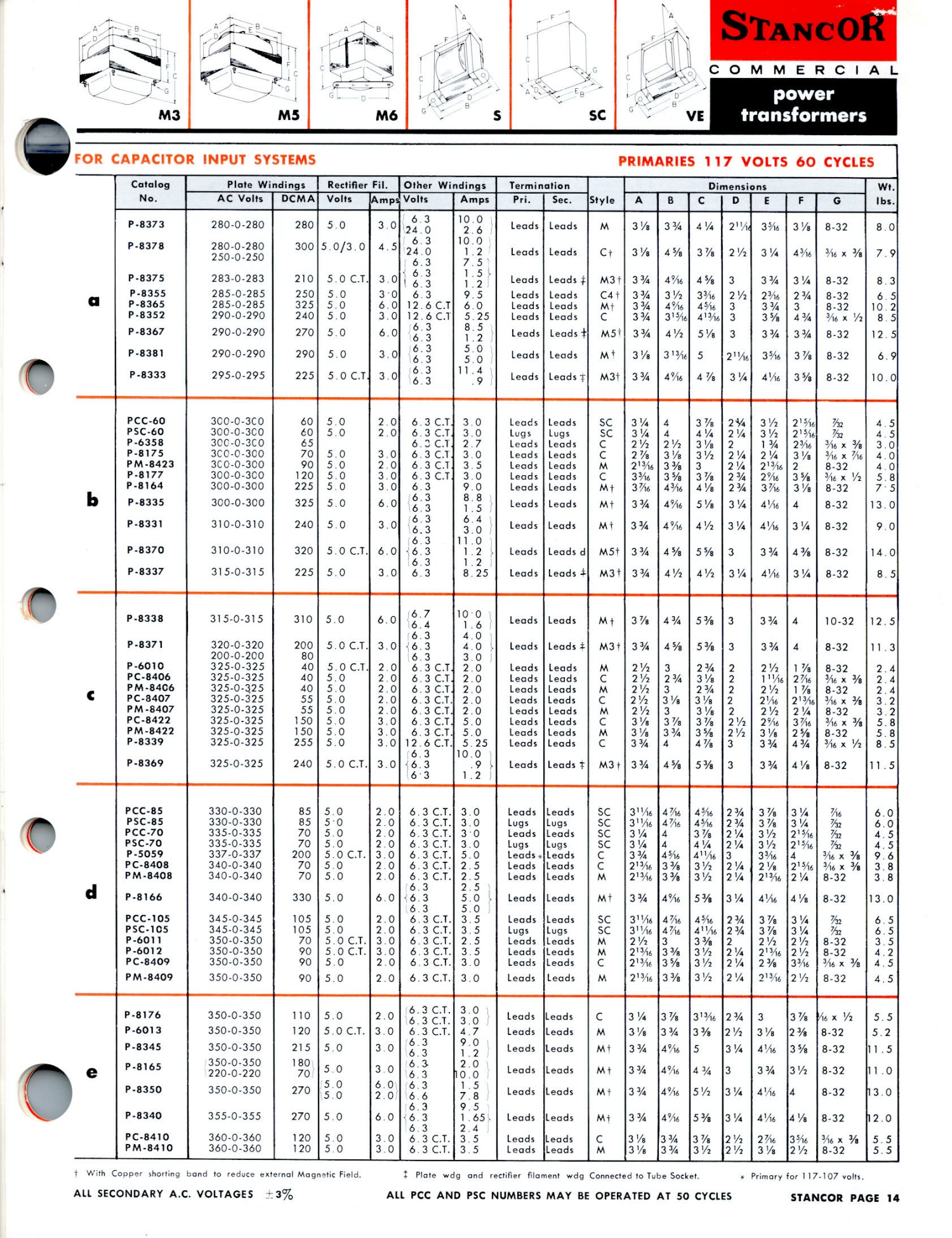

Probably easier to look up the old stancor transformer data book. There are only 2 i believe that have the correct voltages taps,and size and ratings that match what was used. One has a dual tap . Its been a while since i looked.
Just search the bunker of doom Stancor transformer books.
http://www.bunkerofdoom.com/xfm/stancor ... 66_014.jpg
