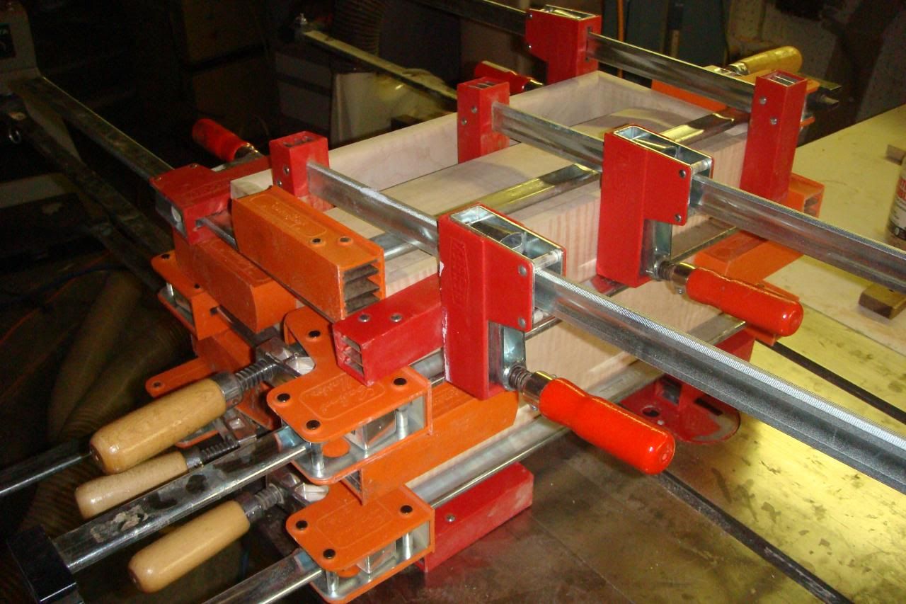

If you want the joints to fit it is hard to beat big clamps.
Here is a picture showing one of my cabs while it is drying.
The cab has between 13 and 15 clamps.
I would rather ober do it than have gaps in the miters.
Another advantage to using these is it allows you to adjust the wood slightly so you can make adjustments in the wood position.
Moving the whole thing once the clamps are applied is rather interesting

- LarryLarry
- Posts: 199
- Joined: Wed Nov 29, 2006 6:18 am
- Location: Savannah GA
Re: How to glue biscuit-jointed miter corners for a tight fit?
Geez, that must weigh 50lbs with all those clamps! I now know what to keep an eye out for at yard sales!
