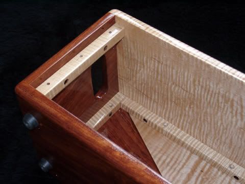

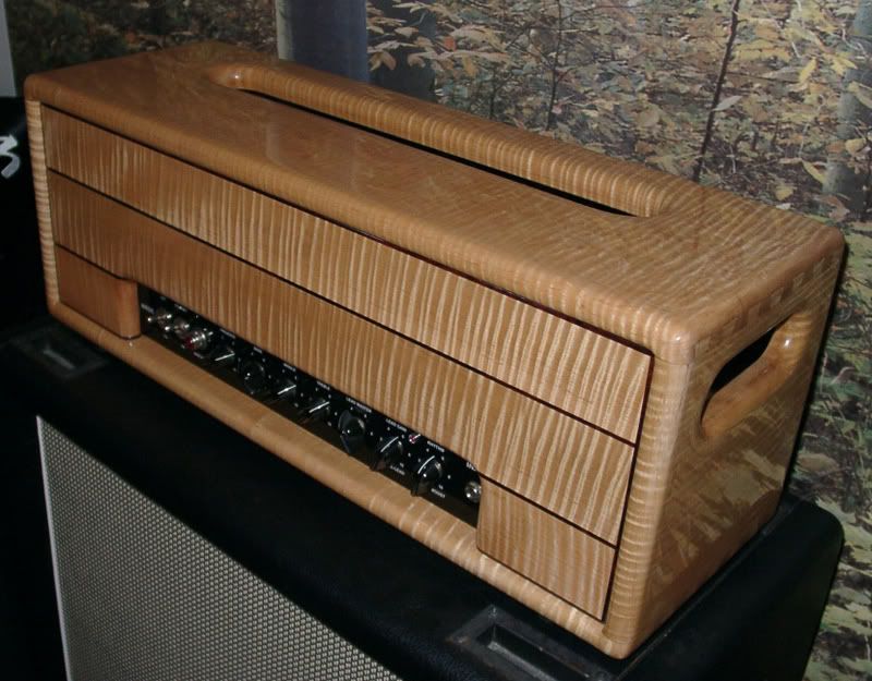

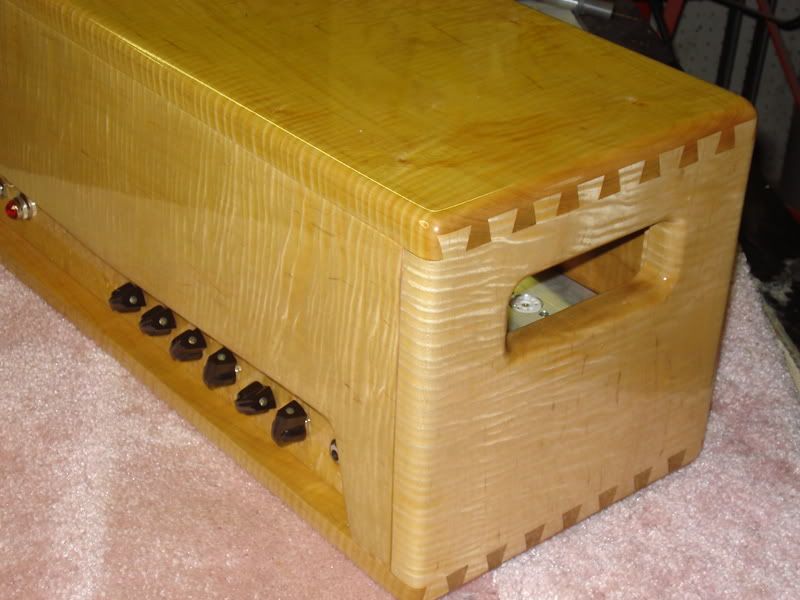

Here are three cabs I built a while back that do what you are talking about.
The Bubinga/Flame Maple cab was for a Komet 60.
The all Flame Maple cab was for my Komet Concorde.
And the Flame Maple with the laminated front panel was for my old Wizard Modern Classic. I borrowed this idea from Wizard cabs..
It is a great way to carry an amp...

That's what I'm talking about. Beautiful work Distortion. The middle pic is gorgeous. Even the wife wouldn't mind that in the living room.

That's exactly what I was talking about with the side handles.

Too pretty!
Distortion wrote:Here are three cabs I built a while back that do what you are talking about.

The built in handle really works well for the Wreck style amps... doesn't take away from the natural wood look and also makes moving the amp around very easy.
